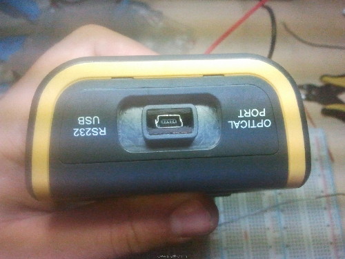

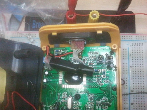

Oživljam staro temo, ker sem izgubil kabel, ki je priložen za funkcijo PC-LINK.
Zadevo sem potem rešil tako, da sem namesto IR ledice in predupora vezal "optospojnik" (optocoupler) z 10mA vhod, ki je biu pri roki. Hotel sem ohraniti ločene mase. Sam RS232 v USB pretvornik (PL2303) sem namestil v ohišje. Je še dosti prostora. Tako se sedaj iz ohišja vidi le mini usb konektor. Zaradi tega mi sedaj ni potrebno nositi dodatnega kabla.
Imam Win 7 (32bit). Priloženi program za funkcijo PC-LINK deluje! V Naprave in tiskalniki nastavite COMx in 2400 8N1 (zadnje verjetno ni potrebno). V sami aplikaciji potem izberete nastavljeni COMx in bi moralo delovati.

Hi heartman,
optical port of the multimeter is replaced with the optocoupler. You can use use almost any type because the speed is so low (2,4 kHz).
On the receiving side of the optocoupler you need an USB-to-serial converter chip, for example FTDI or Prolific. Optocoupler is connected to the RX pin of this chip (data to the computer). The other direction (computer to multimeter) is left unconnected.
USB connection is as per datasheet of the chosen chip.
USB drivers can be downloaded from the chosen manifacturer's site.
