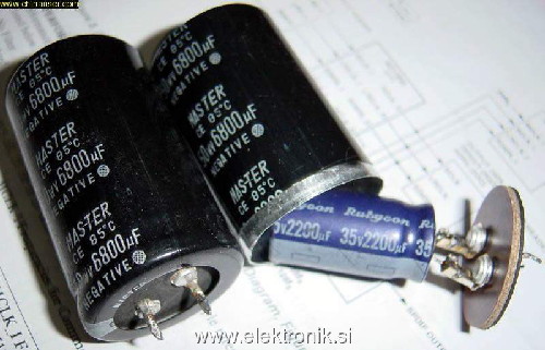

PrispevekObjavljeno: Sob Dec 08, 2007 8:00 pm    Naslov sporočila:  Kitajski kondenzatorji Odgovori s citatom
Ko kupujete kondenzatorje malo potrkajte po njih, da slučajno ne "zvenijo".
Lp Srečko

PrispevekObjavljeno: Sob Dec 08, 2007 9:09 pm    Naslov sporočila:   Odgovori s citatom
S kitajsko robo so samo tezave. Vzorci, ki jih posljejo so dobri, produkcijske kolicine so pa totalno sranje.

PrispevekObjavljeno: Sob Dec 08, 2007 9:57 pm    Naslov sporočila:   Odgovori s citatom
Razlika med kapacitetama vsebine in "embalaže" potrjuje pravilo, da je kitajsko 3x slabše kot od drugih. Twisted Evil

PrispevekObjavljeno: Sob Dec 08, 2007 10:57 pm    Naslov sporočila:   Odgovori s citatom
kje si pa to kupil ?

PrispevekObjavljeno: Ned Dec 09, 2007 1:38 am    Naslov sporočila:   Odgovori s citatom
Zelo me čudi da je notri Rubycon kondenzator, kateri spadajo med dobre in niso poceni (če ni ponaredek Laughing ), dokler nisem dobro pogledal sem bil skoraj siguren da gre za Rulycon.

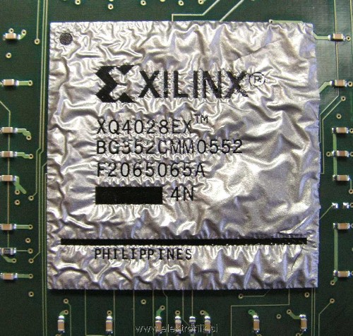

PrispevekObjavljeno: Ned Dec 09, 2007 2:53 am    Naslov sporočila:   Odgovori s citatom
Tole se ti pa lahko zgodi, ce kopujes Xilinxe na prostem trgu.
 Velikost datoteke:  118.83 KB
 Pogledana:  14 krat
Za www.quectel.com

PrispevekObjavljeno: Ned Dec 09, 2007 3:03 am    Naslov sporočila:   Odgovori s citatom
In se text ki je spremljal prejsno sliko:
Once upon a time, there was a Channel Sales customer in Switzerland who
thought he’d save some money and increase his profit by sourcing relatively
high ASP Xilinx components on the grey market.
Having purchased 46pcs XQ4028EX-BG352 from a ‘dealer’, mounting then on the
PCB and then washing them with Zestron, the labels started peeling off….!!??
“Oh no”, said the customer “what shall we do now?”
After completely removing one of the ‘plastic stickers’ the markings of which were:
QX4028EX
BG352 CMM 0552
F2065065A
4N
They quickly realised that the devices were actually marked on the original metal
casing as follows:
XC4028EX
BG352 CMM 9721
F1012574A
3C
“Oh no”, said the customer, “we’ve been ripped-off into buying apparent Mil Spec
4024EX-4BG352N components with date code “0552” and what we’ve actually
received is standard XC4028EX-3BG352C devices with date code “9721”.
What are we going to tell our end customer?”
“I know”, said the Logistics Manager, “we could claim we purchased these
devices via the official channel and ask Xilinx if it’s standard procedure for
them to re-test, re-spec and re-label components in the hope that they will
approve an RMA and ship replacement product”
Xilinx Tech Hotline have since confirmed our initial suspicion that these devices
are FAKE!
Two morals of this story:
Not everything is what it appears to be!
And for the Germans amongst us……”Geiz ist NICHT Geil!”
Feel free to share this true story with any of your customers who need the
adrenalin kick of playing Russian Roulette on the IC Grey Market!
LP Tomaz
Za www.quectel.com

PrispevekObjavljeno: Ned Dec 09, 2007 8:55 am    Naslov sporočila:   Odgovori s citatom
Potemtakem smatram, da je mali kondenzator v velikem ohišju zaradi varnosti pred "deformacijo" Wink .

PrispevekObjavljeno: Ned Dec 09, 2007 12:42 pm    Naslov sporočila:   Odgovori s citatom
@volkd in vsi ostali to ni moj kondezator sem našel sliko na enem Srbskem forumu.
Konkretno na fanzo forumu, ki je namenjen servsiranju TV.
LP Srečko

PrispevekObjavljeno: Ned Dec 09, 2007 1:13 pm    Naslov sporočila:   Odgovori s citatom
Za koliko voltov so "fejk" črni kondenzatorji?

PrispevekObjavljeno: Ned Dec 09, 2007 1:35 pm    Naslov sporočila:   Odgovori s citatom
Piše 50V.

PrispevekObjavljeno: Ned Dec 09, 2007 2:14 pm    Naslov sporočila:   Odgovori s citatom
...notri pa 35V kondenzator....
Ocitno je to samo zascita, pred eksplozijo Laughing

PrispevekObjavljeno: Ned Dec 09, 2007 6:57 pm    Naslov sporočila:   Odgovori s citatom
Tole je ena velika potegavščina. Uporaba nekega kondenzatorja + spajkanje + ohišje večjega kondenzatorja, je preprosto dražje, kot izdelava slabega kondenzatorja v veliko ohišje. Tak kvazi ponaredek je že po občutku lažji in se takoj loči po teži in po občutku, trkanju po njem.

PrispevekObjavljeno: Pon Dec 10, 2007 12:39 pm    Naslov sporočila:   Odgovori s citatom
Če bi odprli še manjši rubikonov kondenzator 2200 uF /35 voltov, je v njem še en kondenzator 470 uF / 16 V.
