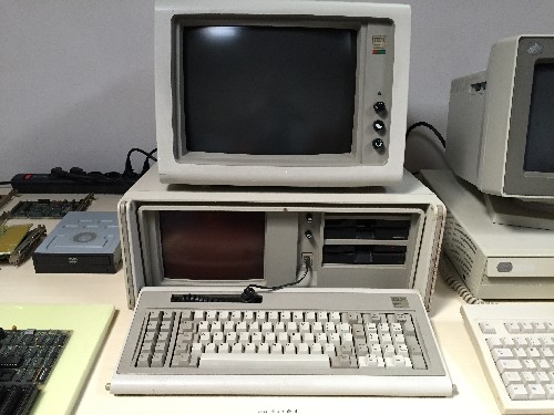

i show u my NMS 9100
I hope you find a Philips NMS case for it, what you could do is go on all big vintage computer forums like vogons.org and ask around there
that IBM 5153 cga monitor tho !

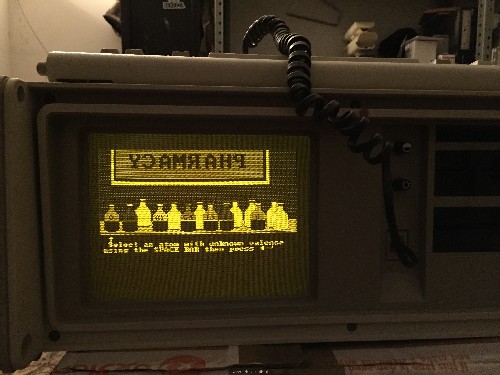

PrispevekObjavljeno: Sre Avg 24, 2016 8:26 pm    Naslov sporočila:   Odgovori s citatom
retro-guy je napisal/a:
Yes retro-gauy, but 5153 is for this Smile
