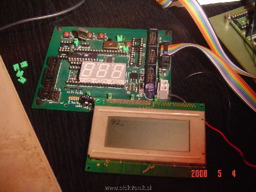

Prvo prebere for zanko nato izpiše na LCD. Saj tako sem gledal v simulaciji.
Koda: |
$sim
Config Lcdpin = Pin , Db7 = Portb.7 , Db6 = Portb.6 , Db5 = Portb.5 , Db4 = Portb.4 , E = Portb.2 , Rs = Portb.1
Config Lcd = 16 * 4
Dim N As Byte
N = 0
Cls
Do
For N = 1 To 255
Waitms 500
Locate 1 , 1
Lcd N
Next
Loop |
573.48 KB |
11 krat |
_________________ Denis |
