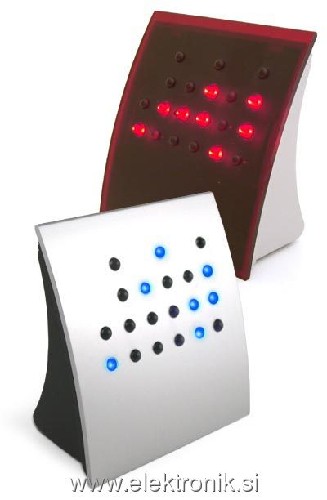

PrispevekObjavljeno: Tor Okt 25, 2011 6:55 pm    Naslov sporočila:   Odgovori s citatom
Zakaj ne - če pri urah to ljudje znajo ...
http://www.google.si/search?client=opera&rls=en&q=binary+clock&oe=utf-8&channel=suggest&um=1&ie=UTF-8&hl=sl&tbm=isch&source=og&sa=N&tab=wi&biw=1886&bih=940
Dober slogan ...
Yes, It's A Clock. No, Your Mom Can't Read It*
*OK, some moms can read it. The kind with degrees in computer science. Our bad.
LP, g

@mucek,
ja kol'ko je zdaj ura: 12:26:16 ali 10:48:36?
