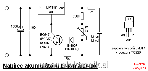

simpe Li-Ion and Li-Pol cell charger
This is a simple charger for Lithium-ion (Li-Ion) and lithium polymer (Li-Pol) cells with well-known integrated circuit LM317. Charging characteristic is shown in the graph below. Charging takes place first in the current mode - Rising voltage, the current is constant. After reaching the target voltage (Umax), the charger goes into voltage mode when the voltage is constant and the current asymptotically approaches zero. At the moment the current is small, the cell is charged. Target voltage of Li-ion and Li-Pol accumulator is usually 4.2 V (for some types 4.1 V) Target voltage is not the same as the nominal voltage. It is generally 3.7 V (sometimes 3.6). The cell does not need to be charged the full 4.2 V, because it decreases its lifetime. If you reduce the target voltage to 4.1 V, capacity drops by 10% but lifetime (nubber of cycles) will increase almost twice. When using the cells, they should never discharge below 3.4 to 3.3 V. Cells Li-ion and Li-pol do not like storing in a charged or discharged state, they should be stored partially charged.
Charger schematic is shown below. Circuit LM317 serves as the voltage stabilizer. Li-Ion and Li-Pol is quite demanding on the accuracy of charging voltage. If you want to charge to full voltage (usually 4.2 V), it is necessary to adjust this voltage to with +/- 1% accuracy. Cells are very sensitive to overcharging. If you charge at 90% capacity (4.1 V), is sufficient a little less accuracy (around 3%). LM317 circuit provides a relatively accurate voltage stabilization. The target voltage is set by trimmer P1. We set it without connecting the cell, because the target voltage corresponds to the output voltage with no load. Stabilization of current is not as critical as the stabilizing voltage, so it is sufficient to stabilise it by a shunt resistor and NPN transistor. If the drop of shunt Rx reaches approximately 0.95 V (the total voltage drop of the NPN transistor's B-E and diode 1N4007) transistor starts to open. This reduces the voltage on the pin adj and so it stabilizes the current. Current is depending on value of Rx. Select it according to the type of charged cell. For charging current 200 mA, I used the value of 4R7. The value of Rx is calculated: Rx = 0.95 / Imax. It is good to connect appropriately dimensioned fuse in series with the cell for safety reasons. Supply voltage should be in the range of about 9 - 24V. Too high voltage increases the power loss of circuit LM317, too low would not allow the proper operation (it is necessary to count the voltage drop on shunt and minimal voltage drop for the integrated circuit). LM317 circuit should be placed on a sufficiently large heat sink. The charger is resistant to short-circuit at the output. LM317 in worst case (short circuit) dissipates a power loss: P = U in x I max. The maximum allowable loss of LM317 in TO220 version is 20W.
Warning! Li-ion and Li-pol cells may explode if a shorted, overcharged, charged or discharged eith too high currents, exposed to high temperature, mechanically damaged
Rx 1,5 ohm, navit cekas na nek upor (5,6K) in polni s 630 mA
Trafo 4 x 9,5 V žica fi 0,7 mm

PrispevekObjavljeno: Pon Sep 12, 2022 7:12 pm    Naslov sporočila:   Odgovori s citatom
Klasična shema CC/CV regulatorja, ki pride v poštev tudi za Pb.
Še moja ideja za izboljšavo:
LED zaporedno s kolektorjem in imaš indikacijo CC (Constant Current).

PrispevekObjavljeno: Pon Sep 12, 2022 8:41 pm    Naslov sporočila:   Odgovori s citatom
LiIon rabi se vsaj UT in OT zascito, fajn je tudi timeout in odklop polnjenja, ko tok pade na 1/10 zacetnega. Za ta namen je na voljo kup namenskih cipov, tako da delati to z LM317 je sicer edukativno, ampak nepotrebno in potencialno nevarno.

Ne trapaj, treba je razlikovati med LM317 z maksimalnim tokom 1,5A in tistim na posnetku iz YT kjer tok preseže 8A
Razumljivo je, da tudi tok 1,5A lahko povzroči pregrevanje... ampak namerno polnjenje na 4,40V in namerno nastavljanje toka na 12A, je dejansko namerno povzročanje požara z namenom ustvarjanja posnetka z vžigom, ki bo pritegnil poglede na YT in s tem povzročil večje število ogledov... Povsem neprimerna primerjava Shame on you
Strinjam se, da izdelava polnilnika z LM317 za današnji čas nekako ni primerna, saj obstaja veliko namenskih bolj "pametnih" kontrolerjev za te namene.
Če že mora biti nekaj starega, je primeren tudi L200
Popolnoma zanesljiv polnilnik najbrž ne obstaja, še tisti s temperaturnimi tipali lahko zataji, tako da... ja, lahko se približamo idealnemu varnemu polnilniku, ampak s preprostimi rešitvami zastarelih stabilizatorjev Think težka bo, saj dela, ampak samo... dokler dela.
Če je s celico nekaj narobe, se bo grela tudi v primeru, ko je polnilnik omejen na max 4,20V, lahko se greje že pri 4,10V tako da je že nevarno.

PrispevekObjavljeno: Tor Sep 13, 2022 6:40 am    Naslov sporočila:   Odgovori s citatom
Tole zadnje glede polnjenja z 1/10 toka velja za NiCd in NiMH, za litijeve nikakor ne. Litij ima tako malo izgub, da lahko rečemo da jih nima, zato tako imenovani "trickle charge" ni dovoljen, ker lahko pride do pregrevanja in uhajanja napetosti navzgor, če končna napetost ni omejena... za razliko od omenjenih, kjer je večinoma dovolj, da je omejen tok in da ne gre za hitro polnjenje.
Pri polnjenju z majhnim tokom in uhajanju napetosti nad 4,3V se celica že lahko greje, zagotovo prihaja do notranjih poškodb in razkrajanja aktivne plasti, uporabna kapaciteta se zmanjšuje, prihaja do mikro prebojev, ...
Potencialna nevarnost seveda obstaja, večji je tok polnjenja, večja je nevarnost in ja, ne glede na zgoraj napisano, spektakularni vžigi so mogoči, ampak ne kar tako hitro in veliko manj pri okroglih 18650, 21700 itd
