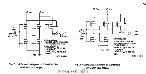

Pozdravljeni
Mene pa zanima zakaj ima IC CD4009 dvojno napajalno napetost. Na nožici 1 Vcc in na nožici 16 Vdd.

Kopirano iz datasheeta:
These hex buffers are monolithic complementary MOS
(CMOS) integrated circuits. The N- and P-channel enhancement
mode transistors provide a symmetrical circuit with
output swings essentially equal to the supply voltage. This
results in high noise immunity over a wide supply voltage
range. No DC power other than that caused by leakage current
is consumed during static conditions. All inputs are protected
against static discharge. These gates may be used
as hex buffers, CMOS to DTL or TTL interface or as CMOS
current drivers. Conversion ranges are from 3V to 15V providing
Connect VCC to DTL or TTL supply.
Connect VDD to COS/MOS supply.
Vcc je za TTL nivoje (5V)
Vdd pa za CMOS (15V)

Chip lahko deluje kot logic level converter iz CMOS na TTL. To pomeni, da na vhod pripelješ napetost ki ni samo od 0 - 5 voltov, ampak od 0 do 20. Del elektronike napajaš z napetostjo, ki jo konvertiraš v TTL. Nikakor pa napajanje ni negativno! Negativnega je dovoljeno le do -0.5 volta. Če je bolj negativno, bo scvrlo chip.

a moram potem na oba priključiti 12v če želim imeti na izhodu 12v

Če bi bral navodila ki so ti jih napisali bi vedel da potrebuješ 2 različni napetosti.

Naredi si spredaj še en usmernik s čipom LM7805 in dodaj kakšen kondenzator. To napetost pripelji na Vcc, na Vdd pa pelji napetost (od 15 do 20V) + dodaj še kakšen kondenzator.

Prebereš Datasheet, ali po domače RTFM!
CD4009UB and CD4010B Hex Buffers/converters my be used as CMOS to TTL or DTL logic-level converters.
