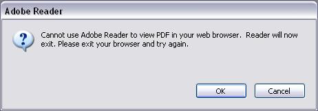

Včeraj sem snel najnovejšo verzijo Adobe Readerja (7.0.8 ) in jo zamenjal s staro šestico. In kot sem že v naslovu napisal, program sedaj noče odpirati .pdf -jev v internetnem brskaliku (Mozilla Firefox 1.5.0.6). Prilagam tudi sliko. Kakšna ideja za rešitev?

www,google,com "Cannot use Adobe Reader to view PDF" izpljune cel kup rešitev. prva med njimi je www,adobe,com (support knowledge base).
Med drugim se ljudje pritožujejo nad firefoxom in acrobatom. Rešitev je:
If you want to keep using Adobe Reader, I suggest getting the Firefox extension PDF Download; opening PDFs outside the browser seems to be relatively problem free. :) https://addons.mozilla.org/firefox/636/
Jur
www,adobe,com (support knowledge base):
Error "Cannot use Adobe Reader to view PDF..." when you open a PDF file in Internet Explorer (Acrobat 6 and 7 on Windows)
Issue
When you attempt to view a PDF in the Internet Explorer web browser, Acrobat or Adobe Reader returns the error, "Cannot use Adobe Reader to view PDF in your web browser. Reader will now exit. Please press the refresh button in your browser to start Acrobat."
Details
You have both Adobe Reader 7.0 and Acrobat 6 Professional or Standard installed on your computer.
Both Acrord32.exe and Acrobat.exe are running in the Windows Task Manager.
During installation of Adobe Reader 7.0, you chose to associate file types to Acrobat 6 rather than Adobe Reader 7.0.
If you attempt to refresh the browser window after you see the error message, you can view the PDF. However, Internet Explorer crashes when you close it. Acrobat.exe remains an active process.
Solution: Install the Adobe Reader 7.0.8 update.
In Acrobat or Adobe Reader, choose Help > Check For Updates Now to install the update.
Alternately, you can download the update from the Adobe website:
-- For Adobe Reader or Acrobat 7.x: Download the 7.0.8 update from the Adobe website at www.adobe.com/support/downloads/ .
-- For Adobe Reader 6.x or earlier: Download the full installation of Adobe Reader 7.0.8 from the Adobe website at www.adobe.com/products/acrobat/readstep2.html . ?

Poiskusi inštalirati firefox 2.0 beta, bi moralo delati.

Jur, to sem že poizkusil, pa ni nič pomagalo. Mislil sem, da je problem v Readerju, pa je bil problem v Firefoxu. LoLek, hvala!

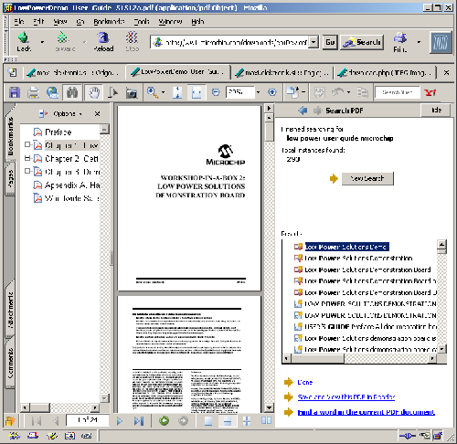

BTW, ali je kdo opazil nacin odpiranja PDF dokumentov v browserju, ce se uporabi google iskalnik? PDF se mi vedno odpre z dodatnim search oknom za iskanje v samem PDF dokumentu. Fuj fuj... kako se izklopi to?

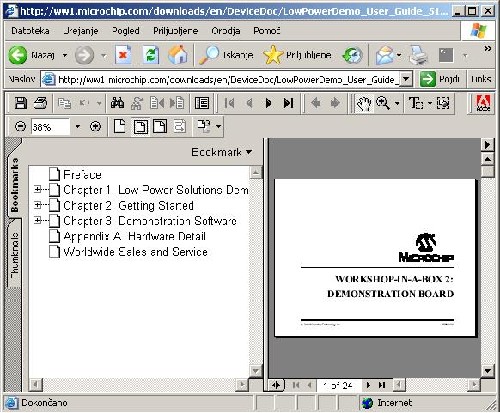

Glitch je napisal/a:
Tale Adobe je zivo sranje od SW! Zmeraj so kaksni problemi.
Kje je problem? Če klikneš na PDF na internetu dobiš nekaj takega, kot je v prilogi. Povsem normalno.

Glitch
Prispevkov: 1477
Aktiv.: 6.31
PrispevekObjavljeno: Sre Sep 06, 2006 12:58 pm    Naslov sporočila:   Odgovori s citatom
Ah, pri meni pa ne.
Torej (kot sem rekel),problematicen je google. Ampak vseeno mi gre na zive Acrobat, ker to omogoca.
v google vrstico sem vtipkal low power user guide microchip (da bi dobil enak dokument kot ti).
prvi zadetek prikaze:
ww1.microchip.com/downloads/en/DeviceDoc/LowPowerDemo_User_Guide_51512a.pdf
vendar pa, ko grem z misko cez, se v status baru browserja prikaze:
http://ww1.microchip.com/downloads/en/DeviceDoc/LowPowerDemo_User_Guide_51512a.pdf#search=%22low%20power%20user%20guide%20microchip%22
Klik na link pa naredi to:

Meni se ob kliku na ta tvoj link (ww1,microchip,com/downloads/en/DeviceDoc/LowPowerDemo_User_Guide_51512a.pdf) pokaže točno to, kot na sliki v mojem prejšnjem odgovoru, kar je prav. Google pri tem nima nič, internet eksplorer verjetno tudi ne. Moj acrobat je verzija 5.0. Verjetno je bistvo različnega prikaza ravno v tem. Koliko je tvoja verzija? Poizkusi uporabiti starejšo.
Tisti panel (tale te moti?) na desni strani okna lahko izklopiš. edit>preferences ali nekje tu v bližini. Nimam novega akrobata pri roki, da bi pogledal...
Nove verzije akrobata imajo preveč nepotrebnih okraskov in delajo počasneje.

Rolling Eyes
Govoris o ednini, podal sem pa dva linka. Klikni na 2. (daljsega).
pa ponovi postopek kot sem ga opisal (iskanje pdf dokumentov s pomocjo googla), potem pa porocaj.
Isto se zgodi z IE.

Ja, kliknil sem na daljšega (pravzaprav na oba). Enak rezultat. V postu sem po pomoti zapisal kratkega.
Meni se ob kliku na ta tvoj link (http://ww1,microchip,com/downloads/en/DeviceDoc/LowPowerDemo_User_Guide_51512a.pdf#search=%22low%20power%20user%20guide%20microchip%22) pokaže točno to, kot na sliki v mojem prejšnjem odgovoru, kar je prav. Google pri tem nima nič, internet eksplorer verjetno tudi ne. Moj acrobat je verzija 5.0. Verjetno je bistvo različnega prikaza ravno v tem. Koliko je tvoja verzija? Poizkusi uporabiti starejšo.
Jur

Jaz pa v tem ne vidim problema, k večjemu prednost, saj že avtomatsko poišče ključne besede v dokumentu. Če te pa zelo moti pa tudi ni težko klikniti HIDE. Wink

jur:
Glede na to, da se v statusni vrstici browserja izpise "daljsi" link pomeni, da je kriv google. To, da se pri "daljsem" linku tebi ne odpe okno kot meni in Maretu, pa pomeni da ima prste pri tem tudi Adobe.
LoLeK:
Kaksne kljucne besede v dokumentu neki no. Ce iscem po naslovu dokumenta, mi nima kaj dodatno iskat pa brskat po samem dokumentu. Zelo nazoren primer je recimo iskalni niz tipa 74lvc245. In sedaj naj acrobat isce to besedo znotraj datasheeta? WTF? Iskanje v pdfjih uporabim samo v res redkih primerih pri zelo nepreglednih user manualih ali knjigah.
Stvar precej najeda! Sploh pri pocasnih serverjih, ki posiljajo samo obcasno stran po stran, za server je to OK, ker ponavadi beres in listas po vrsti in pdf se nalaga v ozadju bolj pocasi. Atmel ima tako narejeno.
