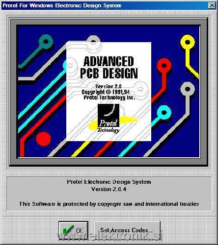

Protel naredi tole:
Koda:
Designator Pattern                Mid X         Mid Y         Ref X         Ref Y         Pad X         Pad Y TB      Rotation
R1         AXIAL0.4            61480mil      75440mil      61680mil      75440mil      61280mil      75440mil  T       180.000
K2         SIP5                61820mil      75320mil      61820mil      75120mil      61820mil      75120mil  T        90.000
R6         AXIAL0.4            61520mil      74980mil      61720mil      74980mil      61320mil      74980mil  T       180.000
R2         AXIAL0.4            60920mil      74940mil      60920mil      74740mil      60920mil      75140mil  T        90.000
T1         TO-92B              60910mil      75160mil      60860mil      75160mil      60860mil      75160mil  T         0.000
D2         DIODE0.4            61200mil      75280mil      61000mil      75280mil      61400mil      75280mil  T         0.000
R4         AXIAL0.4            61480mil      75320mil      61280mil      75320mil      61680mil      75320mil  T         0.000
D1         DIODE0.4            61160mil      75560mil      61160mil      75760mil      61160mil      75360mil  T       270.000
C1         RAD0.1              60460mil      75710mil      60460mil      75660mil      60460mil      75760mil  T        90.000
R3         AXIAL0.4            60520mil      75360mil      60320mil      75360mil      60720mil      75360mil  T         0.000
R5         AXIAL0.4            60540mil      75200mil      60340mil      75200mil      60740mil      75200mil  T         0.000
K1         DB9/F               60005mil      75258mil      60060mil      75040mil      60010mil      75751mil  T       179.709
 Velikost datoteke:  37.12 KB
